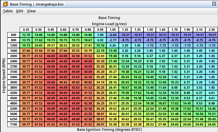

I got a strange ecu image out of it, doesn't seem to match the stock rom "tomsbaja.hex" on romraider at all with lower boost values and really strange zeroed tables (zeroed idle c? negative base timing values?). I'd attach it but it seems the forum doesn't allow bin or hex extensions.

scooobydu wrote: Sat Jan 11, 2025 10:27 pm I got a strange ecu image out of it, doesn't seem to match the stock rom "tomsbaja.hex" on romraider at all with lower boost values and really strange zeroed tables (zeroed idle c? negative base timing values?). I'd attach it but it seems the forum doesn't allow bin or hex extensions.
Looked at the ROM and what I see, looks normal. Base advance values are many times negative on high load/low rpm area. That corner is an area where it would never be, so basicly it doesn't matter what the values are but it looks nicer that way :) Idle Target C table shows normal idle values for me. All other tables also looks quite normal.

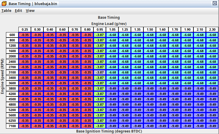

Posted: Mon Jan 13, 2025 3:47 pm
by scooobydu
I guess I got confused by this view in Romraider, which I guess is a diff view that I couldn't seem to turn off even after closing the other file.
Screenshot at 2025-01-13 05-43-12.png (129.65 KiB) Viewed 550511 times
Renaming and reopening it resulted in this more normal view:
Screenshot at 2025-01-13 05-41-51.png (55.02 KiB) Viewed 550511 times
Tbh I thought the colors in Romraider were cooler lol that's why I used it :oops:
