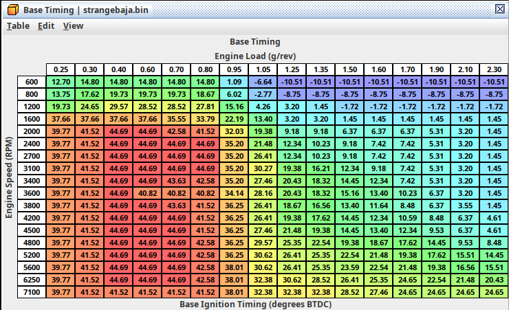

I got a strange ecu image out of it, doesn't seem to match the stock rom "tomsbaja.hex" on romraider at all with lower boost values and really strange zeroed tables (zeroed idle c? negative base timing values?). I'd attach it but it seems the forum doesn't allow bin or hex extensions.

Ah it seems gz is an allowed extension.

scooobydu wrote: Sat Jan 11, 2025 10:27 pm I got a strange ecu image out of it, doesn't seem to match the stock rom "tomsbaja.hex" on romraider at all with lower boost values and really strange zeroed tables (zeroed idle c? negative base timing values?). I'd attach it but it seems the forum doesn't allow bin or hex extensions.
Looked at the ROM and what I see, looks normal. Base advance values are many times negative on high load/low rpm area. That corner is an area where it would never be, so basicly it doesn't matter what the values are but it looks nicer that way :) Idle Target C table shows normal idle values for me. All other tables also looks quite normal.

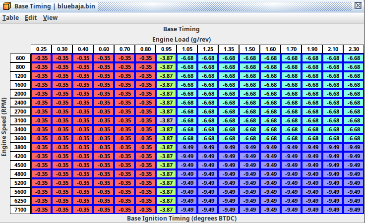

I guess I got confused by this view in Romraider, which I guess is a diff view that I couldn't seem to turn off even after closing the other file.
Screenshot at 2025-01-13 05-43-12.png (129.65 KiB) Viewed 550006 times
Renaming and reopening it resulted in this more normal view:
Screenshot at 2025-01-13 05-41-51.png (55.02 KiB) Viewed 550006 times

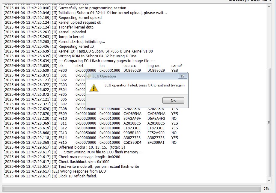

I have an A2WD012B ECU.
read - ok.
Write:
Code: Select all
	A302772B	A302772B	YES
[2025-04-06 02:39:41.688] (DD) Response:
[2025-04-06 02:39:41.703] (II) FB15	0x00070000	0x00010000[2025-04-06 02:39:41.703] (DD) Sent: be ef 00 09 02 00 07 00 00 00 01 00 00 c0
[2025-04-06 02:39:41.735] (DD) Response: be ef 00 05 42 93 aa b2 77 5a
[2025-04-06 02:39:41.735] (DD) ROM CRC: 0x93aab277 IMG CRC: 0xef2009a1
	93AAB277	EF2009A1	NO
[2025-04-06 02:39:41.944] (DD) Response:
[2025-04-06 02:39:41.949] (II) Different blocks : 10, 13, 15,  (total: 3)
[2025-04-06 02:39:41.949] (II) --- Start writing ROM file to ECU flash memory ---
[2025-04-06 02:39:41.949] (II) Check max message length[2025-04-06 02:39:41.949] (DD) Sent: be ef 00 01 05 b3
[2025-04-06 02:39:41.955] (DD) Response: be ef 00 05 45 00 00 02 00 f9
: 0x0200
[2025-04-06 02:39:41.955] (II) Check flashblock size[2025-04-06 02:39:41.956] (DD) Sent: be ef 00 01 06 b4
[2025-04-06 02:39:41.960] (DD) Response: be ef 00 05 46 00 00 10 00 08
: 0x1000
[2025-04-06 02:39:41.960] (II) Test write mode off, perform actual flash write
[2025-04-06 02:39:41.961] (DD) Sent: be ef 00 01 20 ce
[2025-04-06 02:39:41.964] (DD) Response: be ef 00 03 7f 20 06 55
[2025-04-06 02:39:41.964] (EE) Wrong response from ECU
[2025-04-06 02:39:41.964] (II) Block 10 reflash failed.

another laptop on win7.
sub_ecu_denso_sh7055_04:
Code: Select all
[2025-04-06 12:15:56.652] (DD) Response:
[2025-04-06 12:15:56.668] (II) Different blocks : 10, 13, 15,  (total: 3)
[2025-04-06 12:15:56.668] (II) --- Start writing ROM file to ECU flash memory ---
[2025-04-06 12:15:56.668] (II) Check max message length[2025-04-06 12:15:56.668] (DD) Sent: be ef 00 01 05 b3
[2025-04-06 12:15:56.668] (DD) Response: be ef 00 05 45 00 00 02 00 f9
: 0x0200
[2025-04-06 12:15:56.668] (II) Check flashblock size[2025-04-06 12:15:56.668] (DD) Sent: be ef 00 01 06 b4
[2025-04-06 12:15:56.668] (DD) Response: be ef 00 05 46 00 00 10 00 08
: 0x1000
[2025-04-06 12:15:56.668] (II) Test write mode off, perform actual flash write
[2025-04-06 12:15:56.668] (DD) Sent: be ef 00 01 20 ce
[2025-04-06 12:15:56.668] (DD) Response: be ef 00 03 7f 20 06 55
[2025-04-06 12:15:56.684] (EE) Wrong response from ECU
[2025-04-06 12:15:56.684] (II) Block 10 reflash failed.
