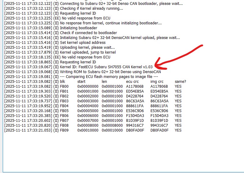

Re: Questions about Renesas SH7055. Crc and kernel
Posted: Tue Nov 11, 2025 4:44 pm
by MiikaS
Ok, well, my bad also :oops:
I downloaded that kernel from drive and it still had old addresses... uploaded just new one, should be updated. But confirm please first that in your kernel what you just used, addresses in 0x24 on are FF FF 90 00 FF FF B1 44... if not, download it again from same link.

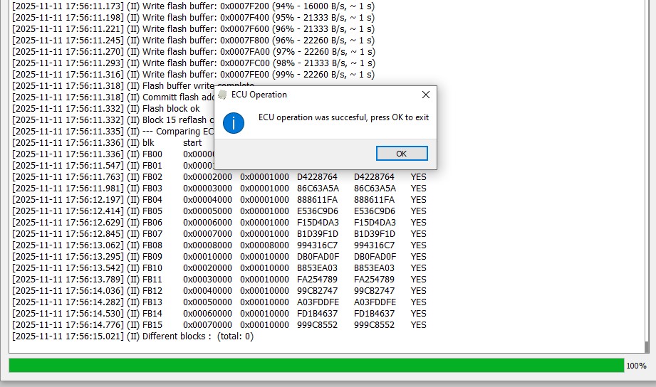

Posted: Tue Nov 11, 2025 4:56 pm
by Zombie47
Yahoooo we did it!)) All it works!
