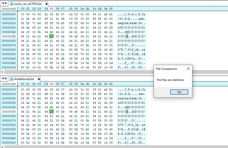

I also discovered that the kernel densocan7055 reads firmware, but can only write to the ECU and not to the TCU.
I started looking into it, but I got even more confused. The kernel file (ssmk_can_sh7055.bin) is 7092 bytes.
But 5832 bytes are transmitted over the channel.
kernels.rar
(9.5 KiB) Downloaded 1049 times
The checksums are different, even though the core is the same. But I see the code isn't checking.

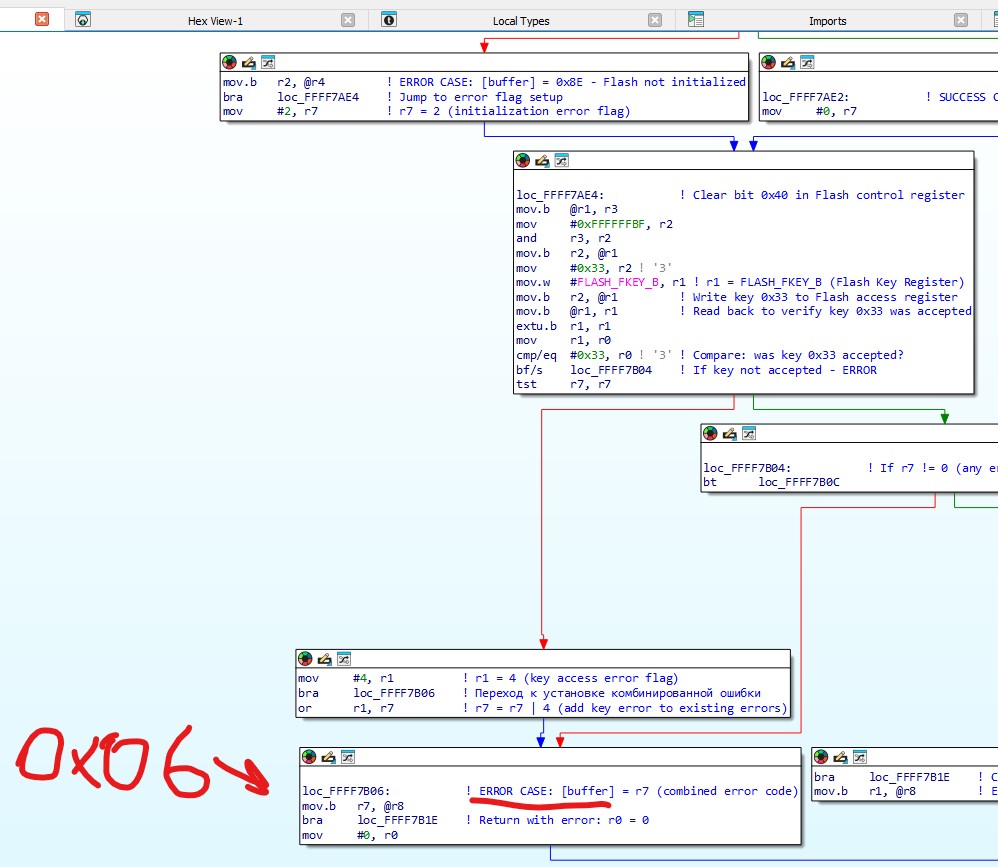

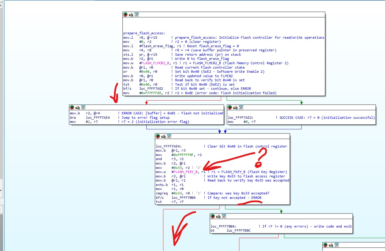

I disassembled the entire ssmk_can_sh7055.bin kernel and found a place where the kernel returns error 0x06 when trying to write to the FLASH_FLMCR2 register 0x40 (SWE2).

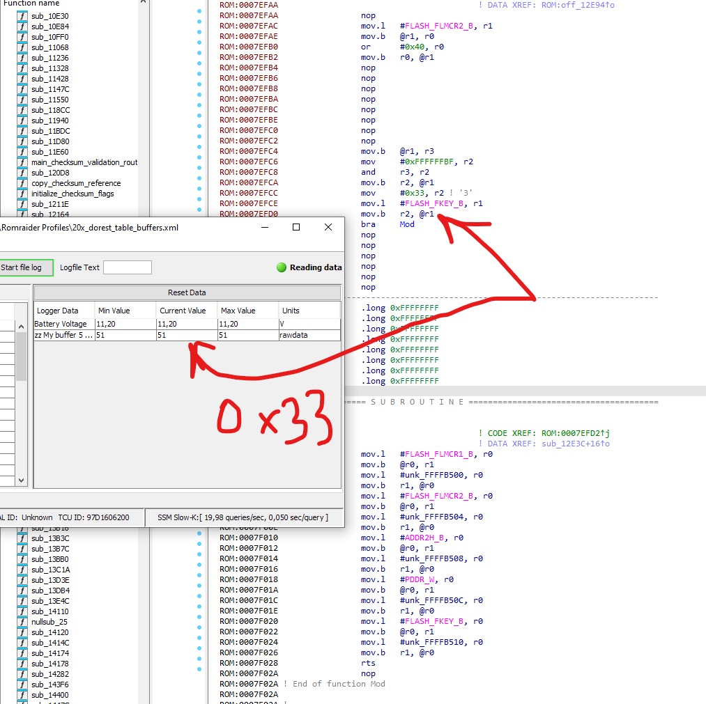

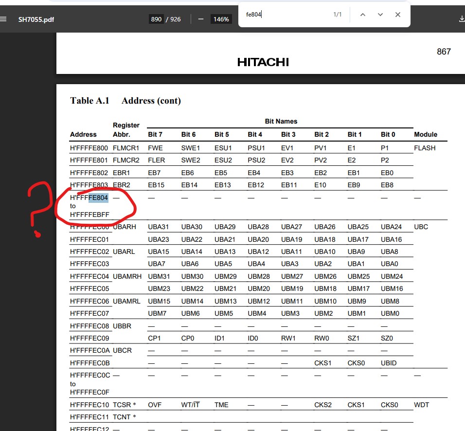

And what is this flash register FLASH_FKEY_B (FFFFE804)?
It has an address that isn't listed in the datasheet.

If I remeber right, that was due to 180nm version of sh7055, which has completely different flash method vs. 350nm sh7055, it's basicly identical to sh7058. Need to check from kernel sources... some newer sh7055 ECUs also uses 180nm version of sh7055. Due to lack of time I couldn't get it working as I had no 180nm version ECU.

Zombie47 wrote: Fri Nov 07, 2025 3:50 am And what is this flash register FLASH_FKEY_B (FFFFE804)?
Ok, took a quick look for kernel sources to refresh memory.
There is some registers and values tested to see if silicon is 350nm or 180nm.
Flash register FLASH_FKEY_B (FFFFE804) exists ONLY in 180nm versions, so failing to write this register in kernel code provides us info that silicon is 350nm. If kernel is able to write this register, silicon is 180nm and errorcode is 0x04.
Then there is another test for settings bit SWE2 in FLMCR2 register in 350nm silicon, which points to read-only memory address in 180nm silicon. So, failing to write this register proves silicon is 180nm and errorcode is 0x02.
It does tests and combines errorcodes, so errorcode 0x06 means that both tests failes so silicon is 180nm. There is not yet working code for SH7055 180nm silicon.
Yes, I understood that. But I assumed it was a double check to see if the registers could be written to.
This is very interesting information because they both have the marking 64F7055F40.
And it's even more interesting after your message. I made my own mini-mod in ROM, and when I simply write 0x33 to the FLASH_FKEY_B (FFFFE804) on a board with 180 nm silicon, everything works. I can do it.
But I can't write to this register on 350 nm.

Zombie47 wrote: Sat Nov 08, 2025 2:31 pm I made my own mini-mod in ROM, and when I simply write 0x33 to the FLASH_FKEY_B (FFFFE804) on a board with 180 nm silicon, everything works. I can do it.
Yes, the point is when you can't write that register, it's 350nm silicon.

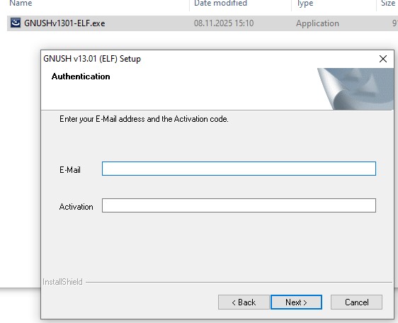

Thank you for:
SH toolchains found here
https://drive.google.com/drive/folders/ ... drive_link

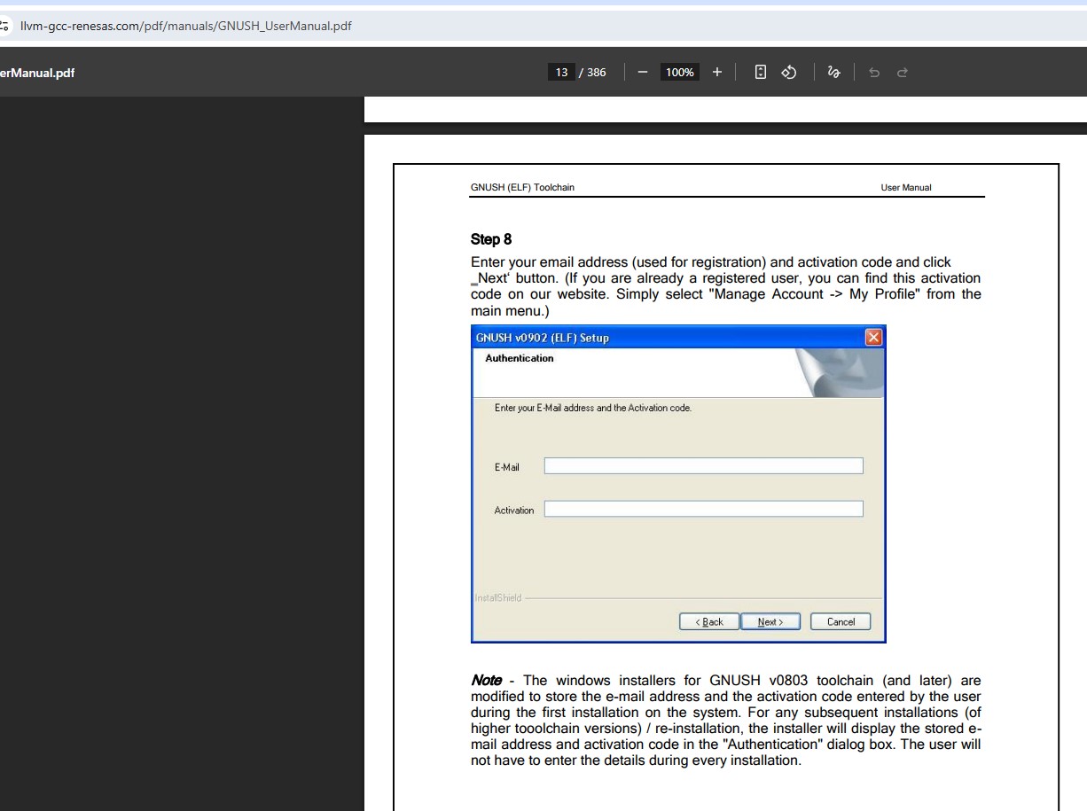

But for Windows "GNUSHv1301-ELF.exe" registration is required, but the site is not working. :cry:

Zombie47 wrote: Sat Nov 08, 2025 10:38 pm Thank you for:
Well, that's new for me 😫 I now it needs registration to download them but does it need also when installing in Windows?
Or was it that my drive link wasn't working?

Yes, registration is required when installing a file using your link.
The website is down: https://llvm-gcc-renesas.com
The download links are broken
But the link to the manual is working: https://llvm-gcc-renesas.com/pdf/manual ... Manual.pdf
I'm still trying to figure out why your kernel ((ssmk_can_sh7055.bin) can't write to the FKEY FFFFE804, but my mini mod can. In to SH7055 180nm.
The kernel runs from RAM, and my mini mod runs from ROM.
I don't see yet anything in the SH7058 datasheet that could restrict with writing to the FKEY FFFFE804.
