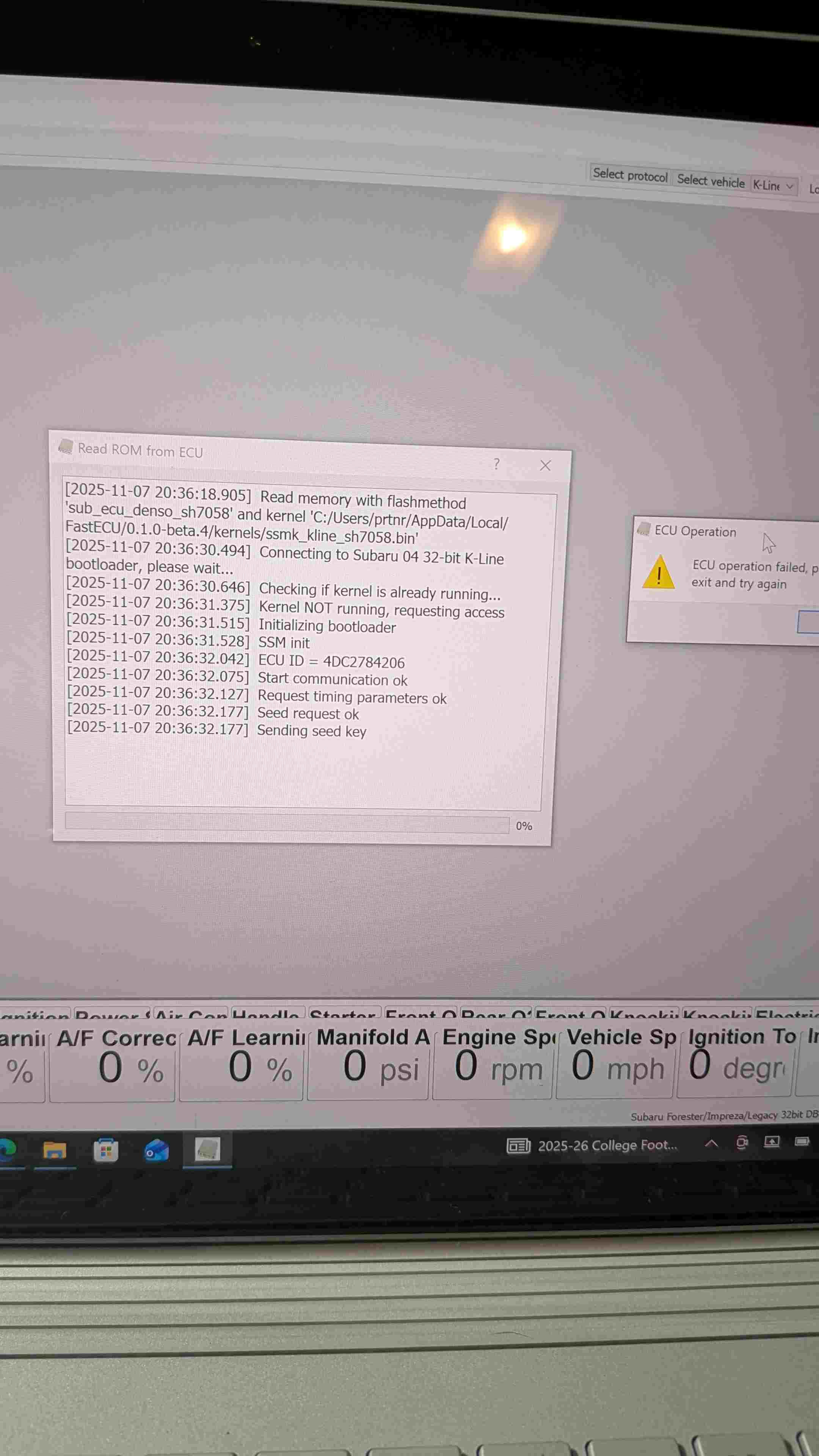

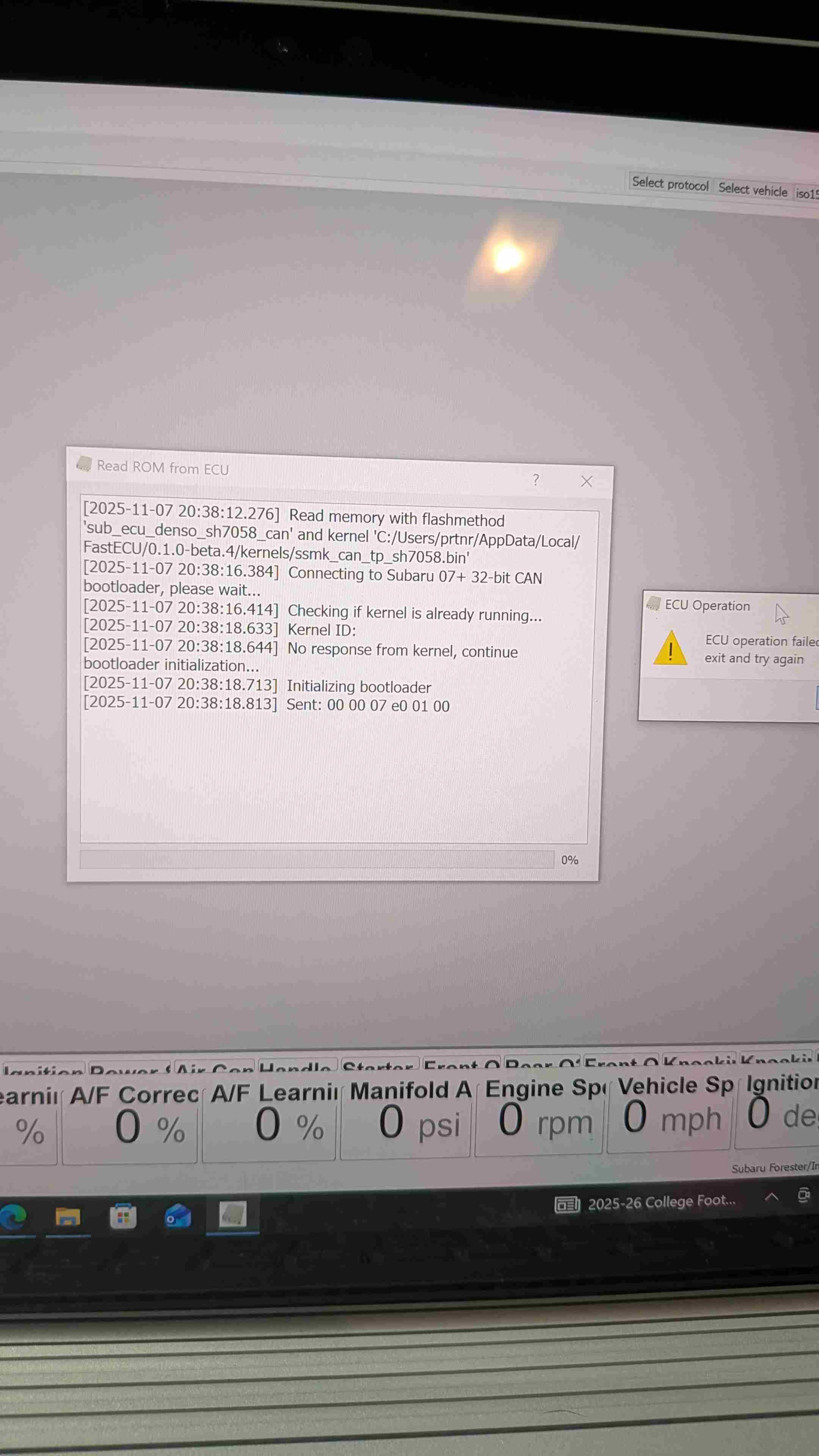

I tried the following DensoCAN protocols:
sub_ecu_denso_sh7058
sub_ecu_denso_sh7058_can
I received the following error messages (see pictures)
Not sure if I'm using the app correctly - I have flashed another 07 STI with ecu flash many times along with many Mitsubishis so I am experienced with Tatrix cables, ecu flash, romraider, and EvoScan
I also tried these with the test mode connector plugged or unplugged with the same results.

Right protocols are sub_ecu_denso_sh7058_densocan and sub_ecu_denso_sh7058s_densocan
BUT, as your log shows, ECU doesn't respond ECU init request via CAN, so they maybe won't work when ECU is in car...

I tried both of those protocols with no success - the only one that appears to have any communication is the 'sub_ecu_denso_sh7058' where it finds the ecu ID.
