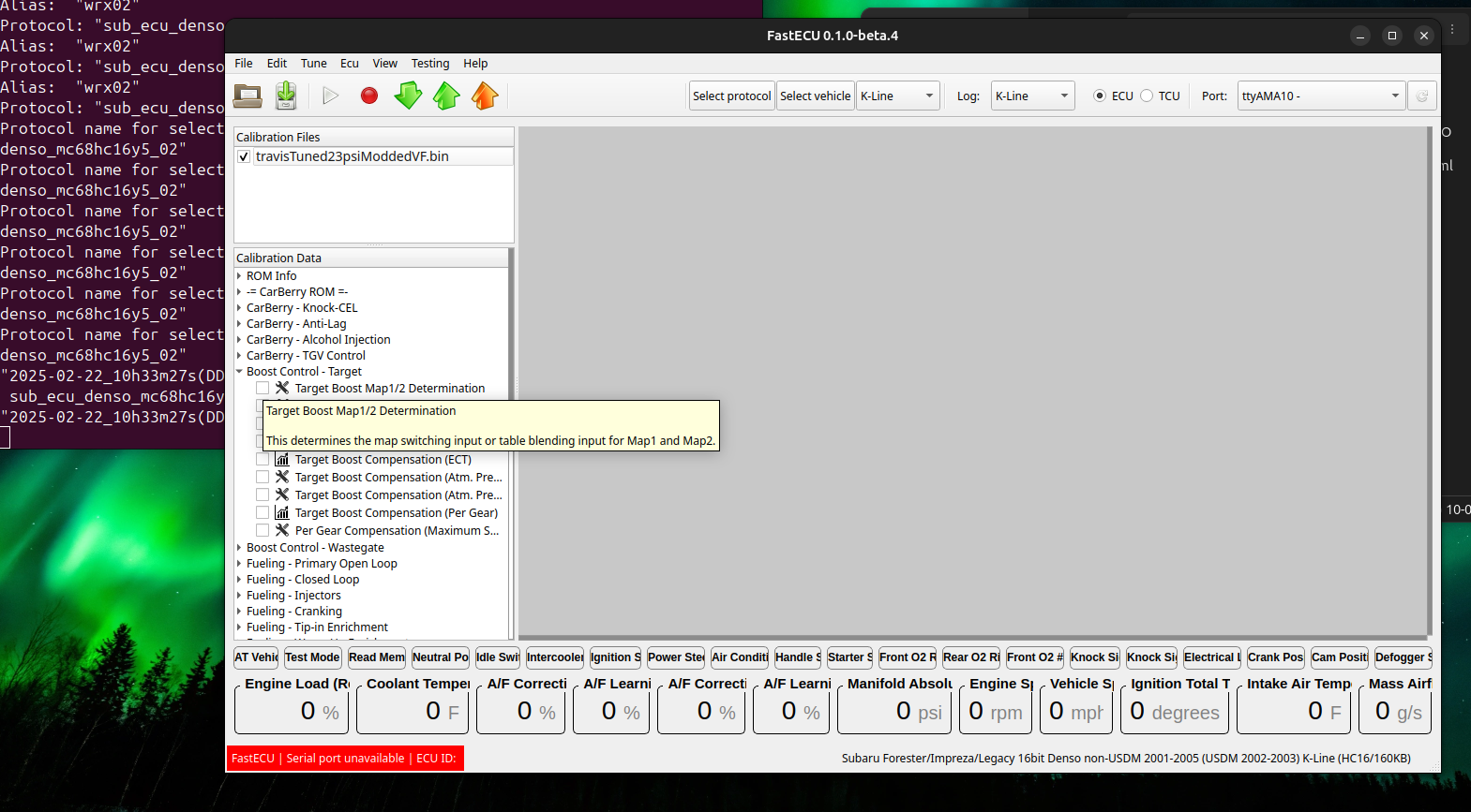

Ok. So I got this running on a Pi 5. Just so others are aware, you will need to run Ubuntu as the Raspberry Pi Official OS(as of today's date) did not contain required libs/dists and after fighting for hours downloading and installing various packages, I just switched to Ubuntu 24.04.02 and the appImage immediately worked following a "chmod +x".
Works great so far but an issue I am seeing now after working through the definitions configured is that at least on the Carberry rom, some tables/fields will cause the app to close with no errors seen in the terminal. Specifically the determination ones(i.e. "Target Boost Map 1/2 Determination", etc). These are used for map switching/flex fuel. Included a screenshot of one such field/table giving the issue. All other tables work correctly though.
Edit* I do see a "Segmentation fault (core dumped)" in the terminal when this happens. Strangely, it worked a couple times(i was able to open that table and change the value) then when I unchecked and opened the field again, it shutdown the app with that error.

Good to hear. I will try to look up definition problem tomorrow.

Main problem with this was different tag used in these CarBerry EcuFlash defs. Fixed and it will be working in next release.Juliandelphiki2 wrote: Sat Feb 22, 2025 8:52 pm Ok. So I got this running on a Pi 5. Just so others are aware, you will need to run Ubuntu as the Raspberry Pi Official OS(as of today's date) did not contain required libs/dists and after fighting for hours downloading and installing various packages, I just switched to Ubuntu 24.04.02 and the appImage immediately worked following a "chmod +x".
