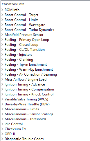

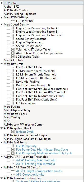

Is reading modified roms possible? Unfortunately none of the modified defs seem to work fully outside of ecuflash.

What OS are you using? I found out few days ago that in Windows 11 somehow categories don't show up when using EcuFlash definitions, but with RomRaider definitions they work and this is under investigations now. Also I will test Dime and MerpMod definitions as soon as I have time to make sure they work.

Just downloaded FastECU, looks very promising, hopefully it goes far! I just tried a Dime file/defs and it opened, but the dime tables were under DTC lol. But pointing it to my ecuflash def folder it opens just fine, all tables show up.
DIME 2.3 rom
RR definition provided by dime
DIME 2.3 rom
