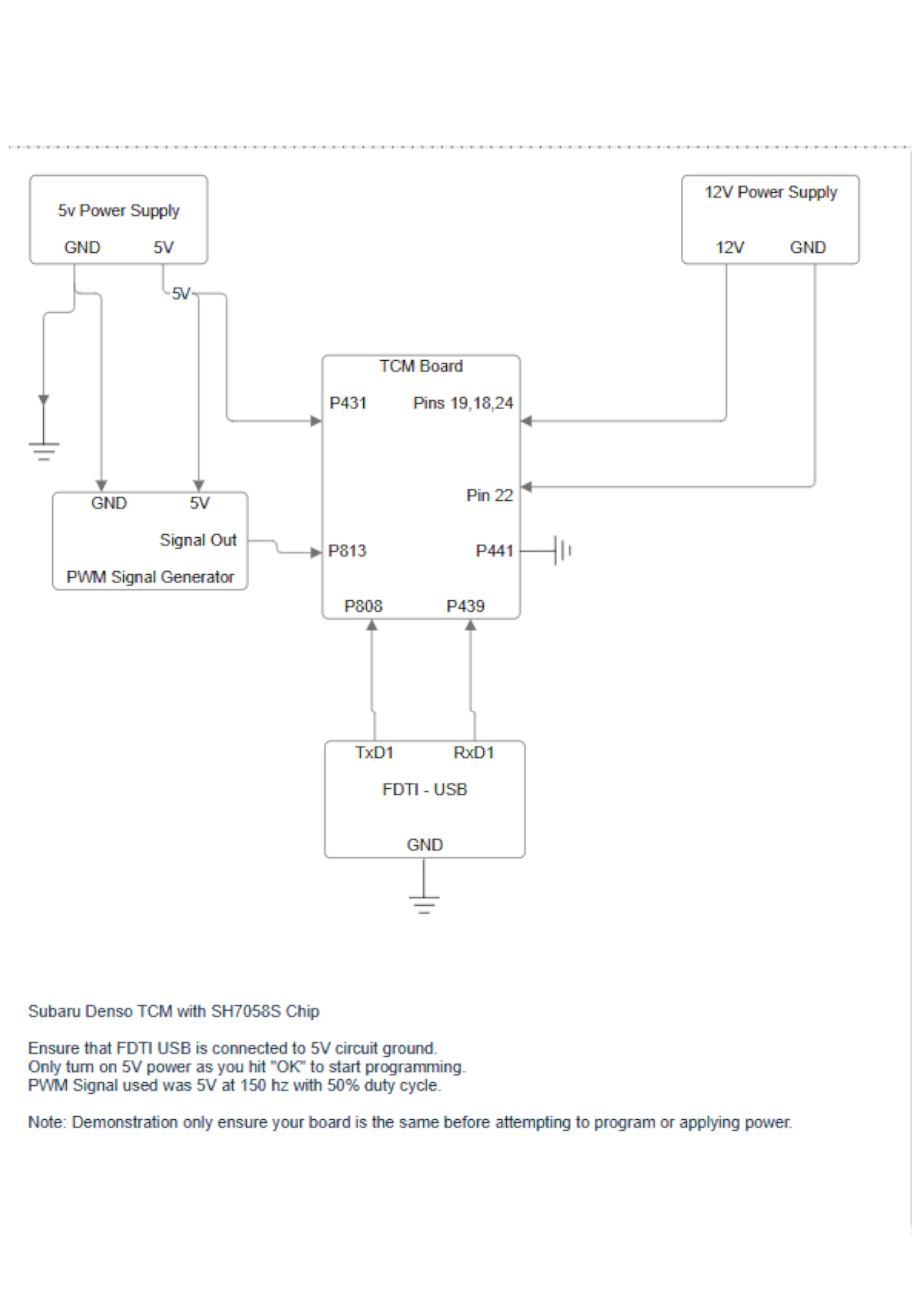

Disconnected leads and hooked up to freessm and was able to communicate with TCM on bench. Will reinstall in the vehicle tomorrow and hopefully it goes ok
I will draw up a schematic and post up so if anyone else has this issue they will be able to recover it.

Attached is the wiring diagram of how i pinned it all out and powered it incase anyone else is ever in this situation with one
Denso TCM SH7058S Pinout.jpg (260.2 KiB) Viewed 497155 times
Also need to attach and earth to the earth side of the diode marked 104 ( there is 3 on the board - any should do)

I am guessing the SHboot command sequence is pretty simple. I wonder if it would be quick thing to add to FastECU?
