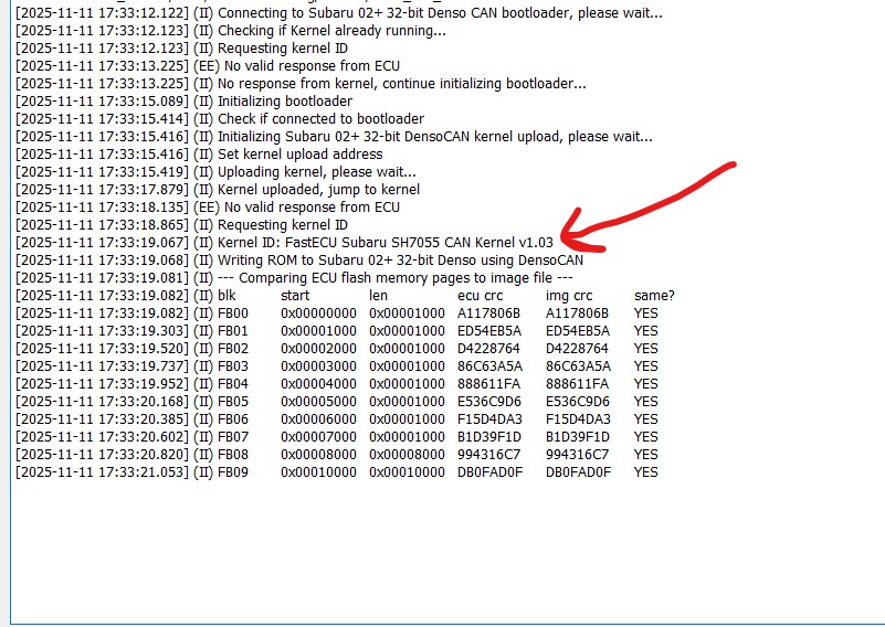

Are you sure you used right kernel?
You're right, I got it mixed up. Could you add the version number here so I don't get confused? That's how I do it myself, but I still get confused with the files.
So far I have the same error. I'm still investigating. Or maybe I've mixed something up again. :D

I downloaded that kernel from drive and it still had old addresses... uploaded just new one, should be updated. But confirm please first that in your kernel what you just used, addresses in 0x24 on are FF FF 90 00 FF FF B1 44... if not, download it again from same link.

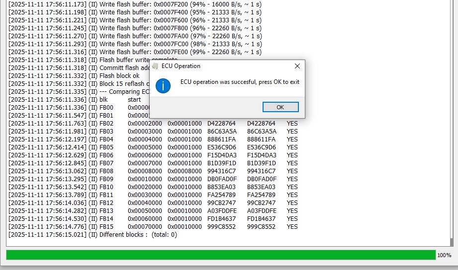

Yahoooo we did it!)) All it works!
