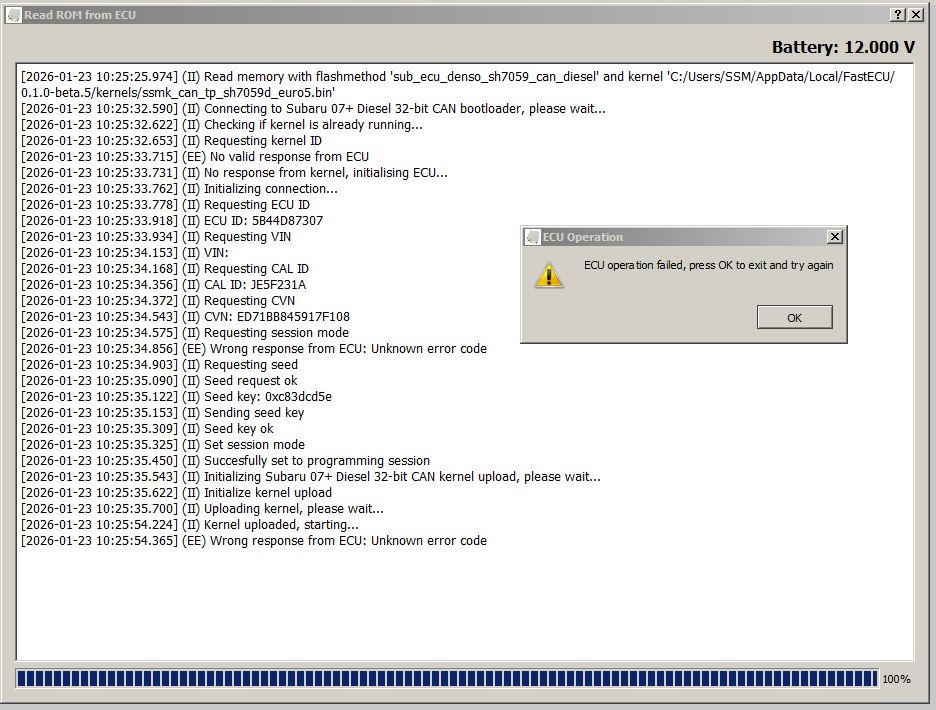

Here are the results with Beta 5. Note I am still using the Mini VCI adapter.
What is also strange is the VIN reported is blank.
Edit: This is also in stdout

Re: 2010 Subaru Outback 2.0D EURO5
Code: Select all
"[2026-01-23 10:37:38.986] (DD) Response: 00 00 07 e8 7f 37 22 "And some ECUs I have seen that VIN request does not return VIN, don't know why is that.
