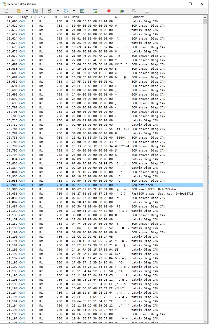

The full log is in the attached screenshot:

Why can't FastECU read this TCU? I see that it doesn't even request the seed/key, but in manual mode, I can request the seed.
