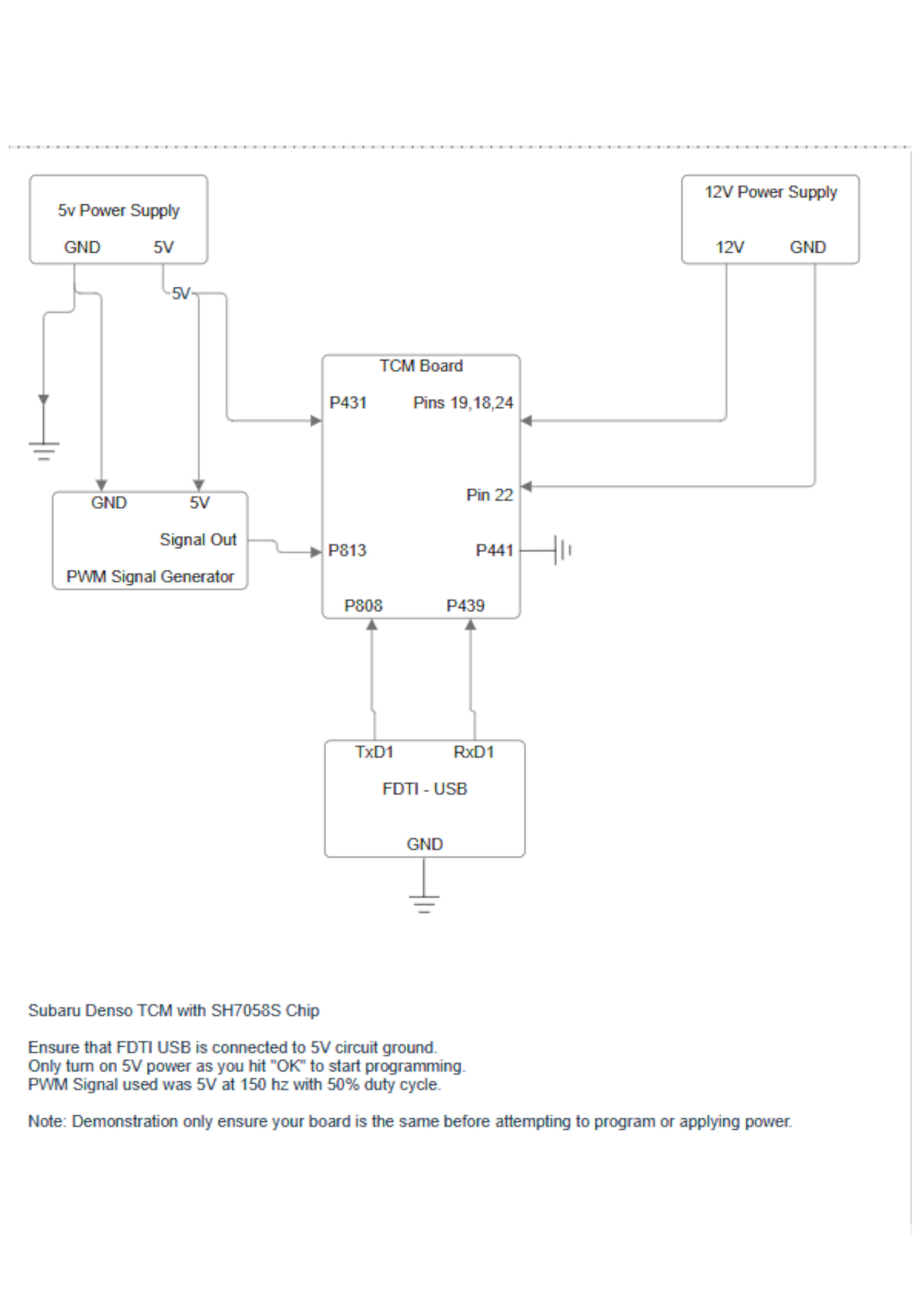

Attached is the wiring diagram of how i pinned it all out and powered it incase anyone else is ever in this situation with one
Denso TCM SH7058S Pinout.jpg (260.2 KiB) Viewed 496731 times
Also need to attach and earth to the earth side of the diode marked 104 ( there is 3 on the board - any should do)
