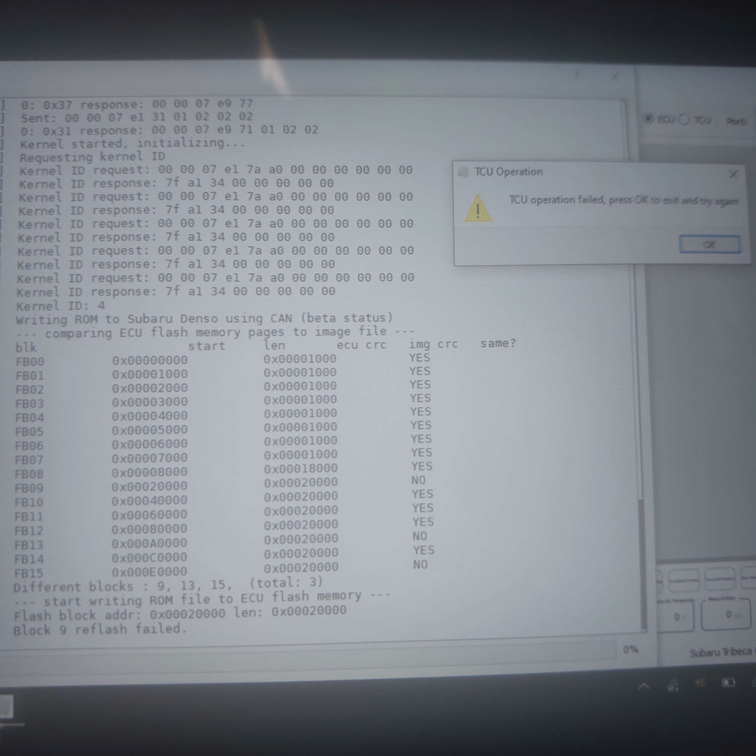

Hello, I've been currently working on definitions for the Denso 7058 CAN TCU roms. I've been able to successfully pull the rom from my TCU without an issue, along doing table definition and checksum fixes within Romraider.
Right now the main issue I'm running into is when flashing, it'd beable to read the flashblocks but once it starts actually flashing, it just fails.
Any help would be appreciated.
