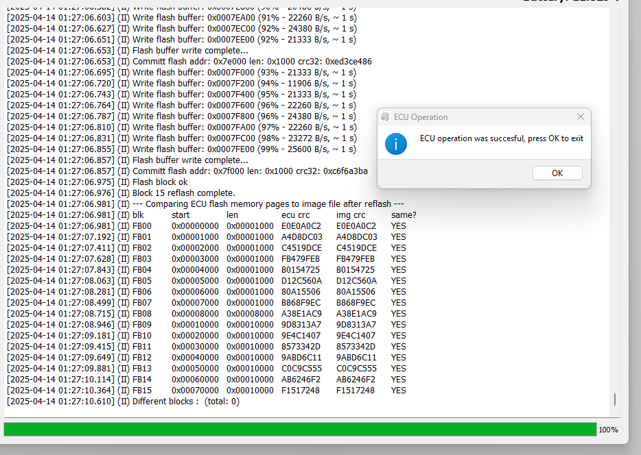

another block sh7055
K-line and can - read without problems
2025-04-14 012721.png (107.61 KiB) Viewed 113717 times

Cortin wrote: Sun Apr 13, 2025 9:30 pm another block sh7055
What is ECU and CAL IDs of this ECU?

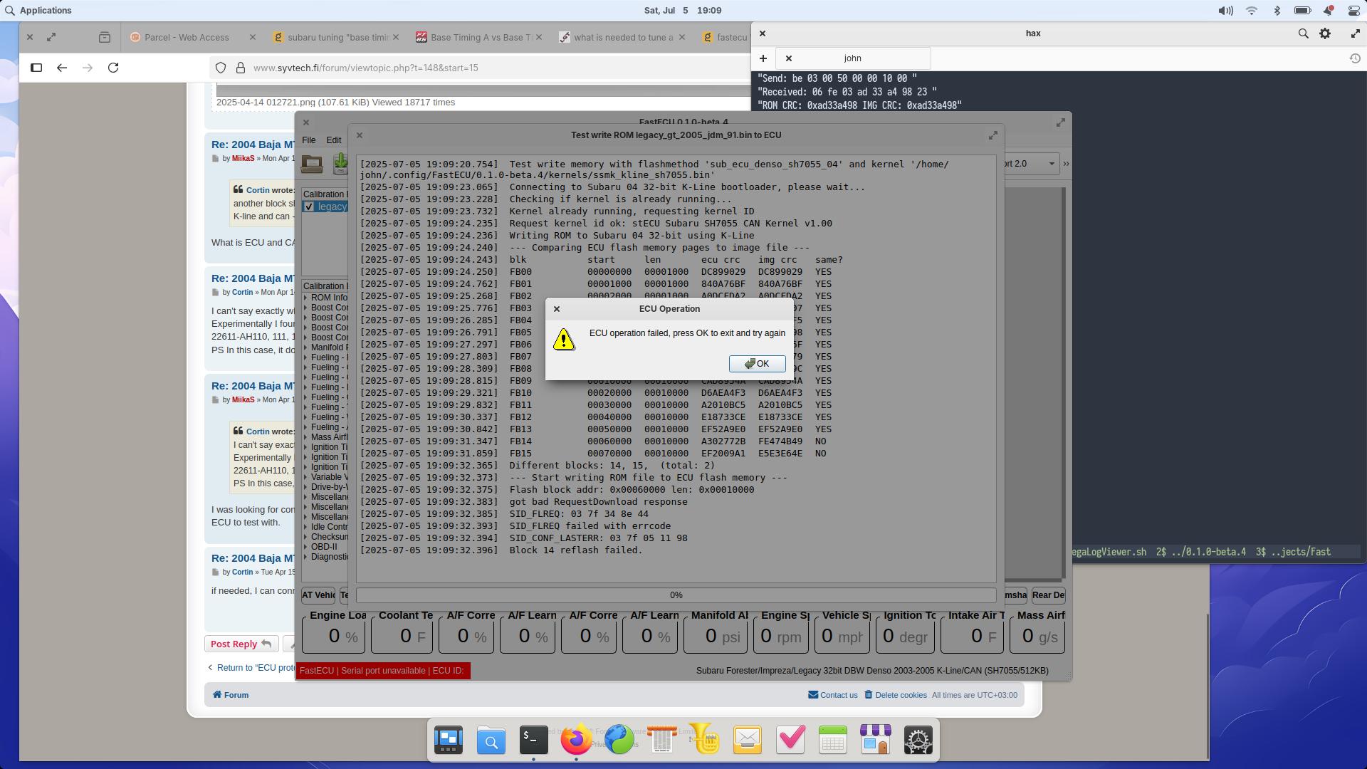

I have a JDM 2005 Legacy GT ECU (Subaru: 22611AK223, XML ID: A2WD012B). When I try a write or test write with FastECU 0.1.0-beta4 (AppImage on Elementary OS 8 (Ubuntu 24.04)), I get this:
